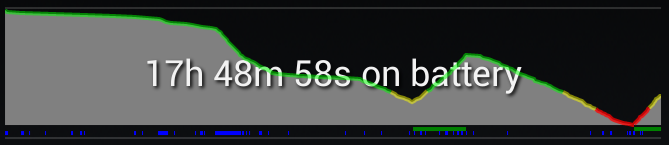

The sawtooth in the attached picture (near the end) seems to show the same sort of issue you're seeing.

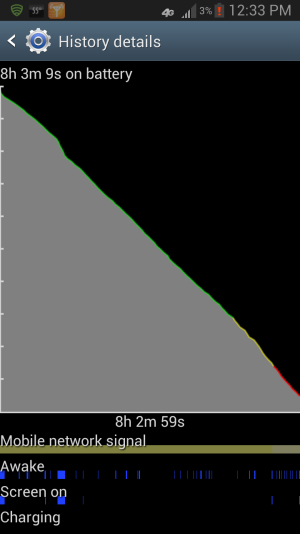

So I had the battery plummet last night, 8 hours and my phone woke me up saying the battery was low. I've been getting 18-19 hrs use, about 5-6 hours of screen on and I had 20 mins of screen on. I live in a LTE area and I generally have good signal. The only thing I had changed was getting an Otterbox Commander case and turning pin lock on. While my screen was black all night, my phone was waking us about 20-25 times during the night, according to battery history. My mobile network bar in battery history was a tan color. I took my case off and it has gone to yellow and green at times. AT&T is sending me a new battery, I reported this to Samsung. I only had the phone for a week before JB came out but I'm still wondering if it has anything to do with JB. I'm really thinking about trading my phone in and just sticking with ICS.

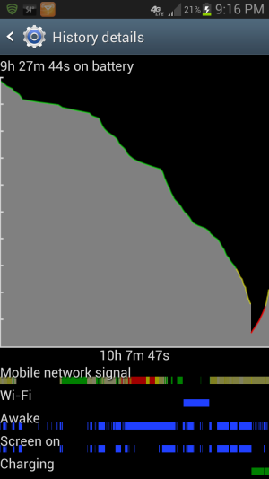

It was like the second I took my phone off the charger, it went down hill fast. Today I haven't gotten great battery, just about 9 hours, but I've also been in a lot of bad signal area today and I have removed the PIN and the commander case.
Here is my battery graph for the plummet and then the 9 hour battery I got today.
