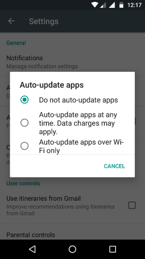

Welcome to the forums. Which option do you have selected in Play Store settings - auto-update apps?

Thank you! This may have been the solution already - it was set to always update!
Yeah, that was my first thought, all that background data could be from apps auto-updating over mobile. It could kill any limited data plan.
It could kill an unlimited data plan also, Javier. After some point, they throttle you - to about 1X speeds, so updating a small app could take all day. And if you keep letting a phone do that, they may just cut off the data connection until the next month.
Okay guys, so we turned off auto updates as suggested, but still the play store started updating apps while being on mobile data. Any more suggestions? =/
That's strange. Try this. Select, in the Play Store, any of the apps that auto-updated, tap on the three dots top right and make sure that the individual auto-update box is not checked.
