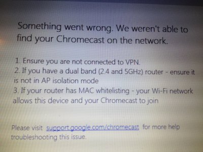

The router is in the basement and covers the main floor above it about 1/2 way down the hall. The Chromecast connects very easily to this network.
For the rest of the floor I have an Amped Wireless extender into which ethernet from the router is connected and all devices in this part of the house have a very strong wireless signal.
The problem is that I can't get the Chromecast to connect to the extender's network, which is where I need it. I get the attached message.
I don't think I have a VPN.
I didn't see AP Isolation in the Amped settings anywhere
I don't know what the 3rd one means
Any help is appreciated!!

Can the Chromecast see the Extender? AP isolation mode might be called something else in the settings.
Yes, it sees it. I go thru the app, type in the password for it and after a short while of trying to add it to the network I get the message above.
