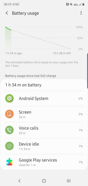

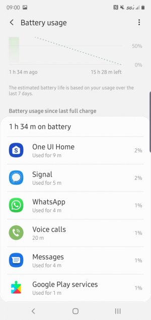

View attachment 308976View attachment 308977

Something doesn't seem right with your phone. The Att issue most of the people are saying their Android system usage is abnormally high. Yours seems fine from your screenshots.
I would get it replaced but try an FDR first, since you'll have to when you exchange it anyways.
Actually his Android system usage is a problem. All the percentages are low the first few hours in the morning. By the end of the day I'd like to see the same battery usage stats and my guess is that he'll be up around 20% for Android System usage.

I read through that thread a little earlier, the one thing that seemed different with most of those instances is that the issue arose after a few days? My battery life has seemed to be poor from day one. The first day I had the device it was dead within 5 hours from full charge. I'll check to see what my android system usage is at the end of the day.

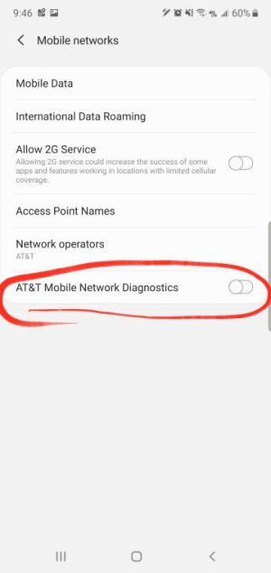

Turning this off is the solution. I turned it off yesterday, and I'm sitting here at 10pm with 60% battery left. I was having the same problem. Do it.
Att here too! Turned off the att mobile network diagnostics and I can really see the diff now! Thanks guys!
I have an ATT note 10+ and haven't been having any battery issues. I just checked and I guess the diagnostics thing is on by default. I am definitely getting better battery life than my note 9.
