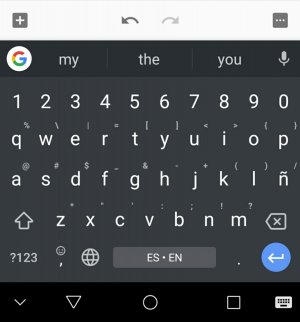

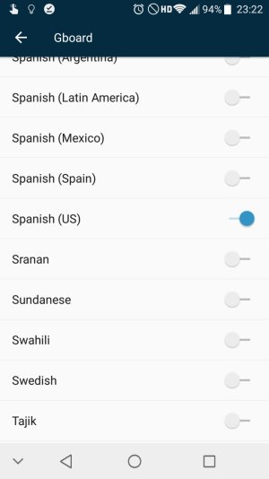

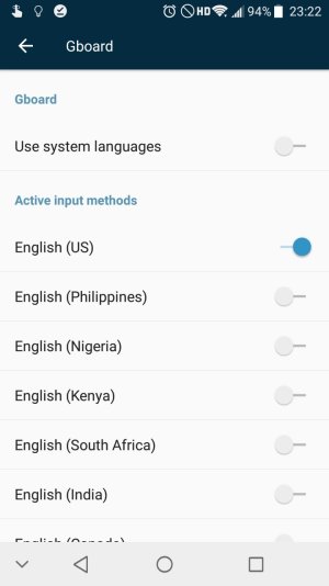

I had the same problem on a ZTE Axon Mini with Android Nougat update... I did have English & Spanish languages selected, and am using Gboard, but needed to go into language settings and deselect system language to allow me to choose English & Spanish individually for the virtual keyboard settings. No download of the languages required. Now I have the keyboard I had gotten used to and love. A clue to success was the ñ key appearing on my 'regular' keyboard. I can now type in either or both languages (i.e., without having to switch) and it just works (without having to choose a specific language for the keyboard).
