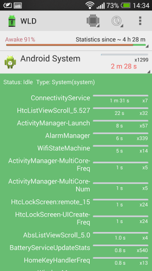

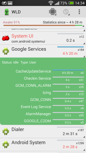

UPDADE:
i installed wakelock and found out that the phone never being able to even go into deep sleep, so something's must be wrong..
i have to screen grabs from the wakelock app:
what else can i do to disable those unwanted continuing services?

i understand this had come up in other forums due to some google service bug in the last few days.
