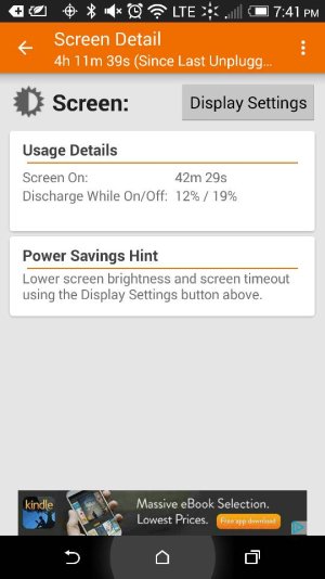

So I'm gonna go this route and post a shot from gsamm and ask for some feedback. I can't for the life of me figure out how people go past 4 hours of screen time wirhout shutting off all functionality.
I keep wifi on all the time. On it most of the day at work. Bluetooth is on. GPS off. Screen is not auto and cut down. Synching 3 Gmail accounts. Facebook doesn't update. Trying to think of settings.
But check out the screen shot. Isn't that a bit of battery used for little usage. Signal is 4glte most of the time. Fairly good reception.
Anyway, feedback is appreciated.
One more thing. Look at my awake time. How do I determine what is causing it to be so high? I can't determine it from gsamm.

Do you need bluetooth on all the time? (Including at work?) Unless there is a reason for you to keep bluetooth on all the time I recommend having it disabled by default. Granted it only accounts for 0.8% of your battery drain (according to GSam) if there is not a reason to keep it on 24/7 (which I also think goes for most people with GPS) you might as well shut it off, and only turn it on when you need it.
According to that GSam report your apps are sucking up the vast majority of your battery (65%). (On my phone apps only account for 24% of my battery drain. 7.4% of that being the OS itself). Click the > next to the 65.5% to see what apps are using up most of your battery. From there click on any of those apps you don't use (or don't plan to use), then click the manage button, and then force stop the ones you don't need running all the time, and disable the ones you never use (and have no plans to ever use).

Same issue with my one. Something Is keeping it awake when screen is off. It says under screen on gsam that screen in 42 minutes. Discharge while on. 12 and off 19
