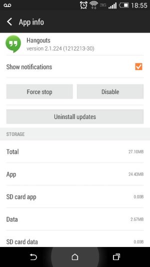

What build number of Hangouts? I can tell you that Hangouts was the sole creator of the problem for me since it was introduced at Google IO last year. I literally did not get the issue fixed until the update a few weeks ago to the Hangouts app.
I highly recommend you do the following: Update to the latest version of Hangouts, which you can see the build number I am using in the screenshot. Clear the cache and data for the Hangouts App.
This should resolve your problem. This is not an issue with your M8.
I am also on Verizon. I always have WiFi on and I can send all messages and pics without them failing. This only became possible on Hangouts without failure when there was an update a few weeks ago.

I have had these issues with the hangouts using sms since the day they started supporting sms, that was when I had my M7, and this issue is the same with my m8, which is why I only use the stock messaging app, and I have no issues. It is actually a hangouts issue, not the phone. Or maybe it is the way hangouts runs on the phone, if you try the stock messages app (which I noticed johnmcc0710 mentioned also) I would be willing to bet your issues will be solved.
Thanks for the advice guys. I've got the latest update and just cleared data and cache. I'll see if that helps. I haven't tested stock app as I just always use hangouts. But if it continues after this attempt I'll test out stock and see how that goes. Something tells me that it is hangouts and it's ways of handling text like y'all said.
Well I tried hangouts again and it continued doing it so I just went to the sick messaging app. I'll see how that goes.
