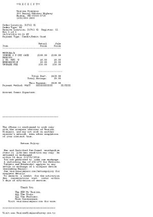

I was able to keep my UDP on my iPhone 6 plus.
This is what I started out with:
iPhone 5s 32gb space gray with UDP with an upgrade eligible
iPhone 5s 16gb silver with UDP (not upgrade eligible)
Samsung Galaxy S4 with 4GB Data Plan (not upgrade eligible)
2 dumb phone lines (not upgrade eligible)
I did not realize Verizon changed policies regarding upgrading dumb phone lines with smart phones, and doing the switch. Luckily, I read about it while waiting in line at the Verizon Store an hour before going in at 8 AM. I read that if you have a TDP, you can transfer upgrade to TDP and then switch over, which was my plan.
I went to the Verizon Store and had them transfer my upgrade to the SGS4 line and had them keep the original data plan on that line. Surprisingly, they still had the 4GB plan for $30 for it. They activated the line with the subsidized iPhone 6 Plus and handed it to me. My line was not affected and I made sure there were no changes when I was transferring upgrade over. Verizon Reps informed me that I will lose my UDP no matter what even if I transferred my upgrade eligibility. They don't know what they're talking about. They said the only way was to either 1. Buy the phone full retail price, or 2. Use another line's upgrade to upgrade that particular phone, and swap SIM cards.
Then, I went online afterwards and had them do a "switch" SIM Card activation, so I swapped my SIM card with the SIM card on the iPhone 6 Plus. I made sure online it kept my unlimited data plan when I did it through my Verizon. My iPhone 5S then became the original SGS4 line. Then I went online again and provided the SIM Card ID for the SIM card in the SGS4 and activated that SIM card on that line. It worked also. So basically, the new SIM card that originally came with the iPhone 6 Plus is inactivated.
I checked my Verizon online and they had listed the right phones under the numbers, and confirmed I still had the UDP with my own line.
I hope this helps for others who wanted to keep their UDP. Unfortunately, from what I've read online, you need to have a TDP available to have this to work. I'm not sure if they actually closed the loophole for dumbphones.
Here is some proof with screenshot and receipt of subsidized phone price. I'm glad that NH has no sales tax!
