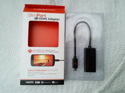

Hi Folks, I've bought a Slimport HDMI Connector to use with my nexus & TV. However, when I plug it in it doesn't work (actually I'm on the 2nd. one, exchanged the 1st in case it was faulty, but clearly not) Do I need an app to make it work, or to change something in settings? Perhaps there's something I must do with the TV? I've tried every which way, but to no avail. Can anyone help please? Oh, my tv is an LG32LD450.

This is the one I have - it's advertised as the right thing. It has a charging port on the side. When I plug it in it shows the Nexus as charging. Perhaps it's the tv. Thanks anyway.

I have that exact cable that I ordered from China but it doesn't work properly.
Using a Google Nexus 7 (2013) and a Panasonic TH-50PX75U TV the cable works for 2 minutes
then the picture rolls vertically and blanks out.
Using the same tablet and a different HDMI cable I connected an NEC Multisync EA243WM.
After working for 2 minutes the display blanks out then shows the message:
"Out of Range"
The supplier has agreed to send me a new cable but I'm bot getting my hopes up.
I have since ordered a slimport from a different manufacturer and supplier.

No, it doesn't have to be a Smart TV. Just make sure the hdmi port you are using works, make sure you have the input on the TV switched to that port #. If it doesn't work once you confirm these 2 things then the slimport adapter is bad.

I bought a Slimport adapter off of ebay and I thought it didnt work after I tried 5 HDMI cables laying around the house. I contacted the seller and he recommended this cable and it works perfect. Ebay HDMI

I too have just bought the same slimport adapter and I have tested it on 3 different displays with 2 different hdmi cables but it doesn't seem to work..

I have the same one and it only works somewhat reliably if the nexus charger is plugged into it.
I think I'm going to return it.

Interesting. The only time I had trouble with mine was right after the 4.4 update. I did a reboot then, and it's been fine since then. Three different TVs and cables.

I have a he generic adapter and use it in hotels. Often the hotel won't allow access to the hdmi inputs. I also found that the tablet has difficulty connecting when the adapter has the power connected. So on both mine and my sister I hook up the cabling without power and after it fires up will then hook up the power and it continues to work perfect. Hopefully you get this square away, it is a real nice option.
