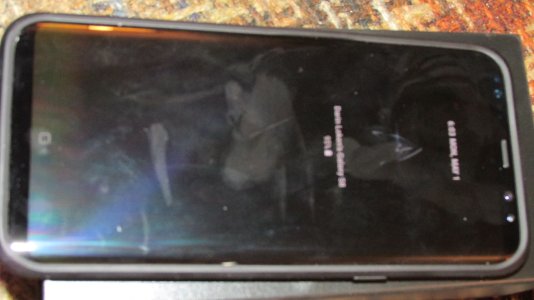

I took this VERY bad pic of my phone. It has the all time display on, and as you can see, barely, it has the time and day on top of an icon I uploaded, with a quote below it. I just went to settings, then to Lock screen and Security, and then I clicked on the words, "Always on Display", NOT the toggle switch, but the actual words. Then it took me to the next page where you get a selection of clocks you can use, even a clock and a calendar, or no clock on the face and just having the info on the side screen. Or like I did, up load your own picture and have the clock info on top of it, and a quote below it if you want a quote. You might need the latest upgrade for this, not sure, if it doesn't work, try going to settings, then down to system updates and see if there's and update for your phone.

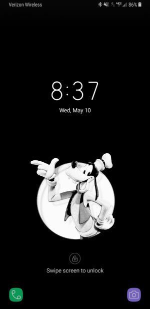

This is how the clock looks when you have notifications. It goes back to being stacked when they are cleared.
@ZOMMBIE1 Thanks for the theme suggestion. I'm new to Samsung and didn't know this existed. Some (but not all) of them do indeed replace the clock.
Yup... Weird looking without notifications.... Normal looking when there are notifications on lock screen...
