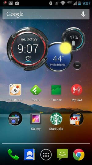

Ok, so I tested this morning and not only do I get Gmail notifications, Google Play automatically updated an app while both bars are white. Curious. I seem to be getting Google services despite not having the phone indicate that I am connected.
My theory? I have Google Services via the 4G connection, but the software has that indicator white based on the fact that I have a good wifi connection. Here is a screen shot.

The image isn't showing on Tapatalk but Wi-Fi negates the LTE and will turn it white. I have never had an Android phone where the signal stays blue. I have seen the Wi-Fi turn white before which is when it wouldn't sync up.
White Signal with WiFi Off - Not connected to Google Sync.
White Signal with Blue WiFi - Connected to Google Sync.
Blue Signal with WiFi Off - Connected to Google Sync
Sent from my Droid Maxx using Tapatalk Pro

Just updated so the pic shows now. The mystery is that the indicators say I am not synced with Google services, but Google services are functioning.
This is clearly not an issue, I am just curious, and may point to a small bug in coding the notifiers.

Ah I see it now. Strange but yes I've always found this to be inconsistent myself.
Ah, that's a good theory. It may be that your work WiFi is blocking the port that Google sync services uses, so the phone is falling back to mobile data, but, for some reason (a bug?), the icon isn't turning blue.
