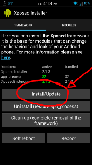

I just flashed b16, and I was wondering if there was a way to change the battery and the time color from ICS blue to white? I can't post in the XDA forum yet.
You can change the battery color here:
settings>custom settings>xposed tweakbox>statusbar>clock color
FIRST: In order for these changes to take effect, you have to go into settings>custom settings>xposed framework installer>modules and check the box for xposed tweakbox [1.4.0].
Then you have to go to the framework tab and press "Install/Update", then reboot your phone. If the change doesn't seem to have worked, pull the notification shade down once, then back up. This seems to give the changes a little kick into taking effect.
I'm sure there are mods and/or themes out there somewhere that will give you the white battery, but as far as I know it's not part of the ROM or stock settings.
