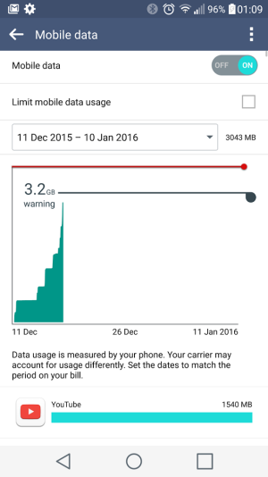

Thank you for replying. I had recorded a 2 minute video that Google Photos would have uploaded (and I put it on Facebook, too) but I imagine that wouldn't have used 2GB? I wonder if that's wrong, as I changed my data usage cycle to yesterday (the day of the screen grabs, as it is now 1am) and it is only showing "Youtube - 575 MB" (my dinner at work) and "Google Services - 298 MB".
Could that be an error with GSam?
I guess it could be an error in GSAM but for me GSAM seems accurate.
What about mobile data graph in system settings? Do you see a 2gb spike there?
Re: Terrible battery life (H815, 6.0 Marshmellow)
Oh and that data use is listed under system and not app data. To me it looks like a syncing issue, probably with photos.
Not that I can see:
I think that's a bug with GSAM? I don't know. I'll change my Google Photos settings to only sync on Wifi though
