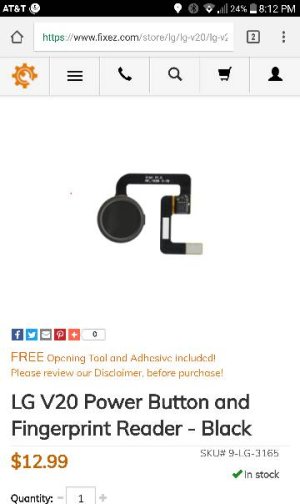

Before replacing the phone, maybe try this? Super cheap option, and the disassembly is easy as pie when you watch videos. If it doesn't work, you're out $13 is all. Better option before trying to replace phone
Could void warranty
Could void warranty
But if it doesn't work, he'd still be out $13. And could reinstall the OEM reader. And if it's through an outside insurance claim to get a new phone, I highly highly doubt they'd notice it had been opened up
I'm wondering if this would actually work? I have replaced screens on iPhones and have read with Samsung that you have to keep the original fingerprint scanner that came with the phone. If you install a different home button/fingerprint scanner, it will not work with the new phone. Maybe LG is different but I know this is the case for Samsung and Apple devices.
