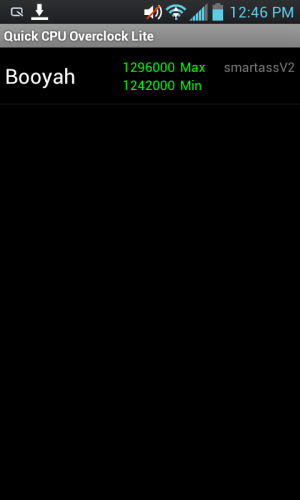

Either dding, adding the modified post.boot, or both did it (was flashing via twrp prior.)
think ed is right regarding loki. After flashing my zip with loki'd no security error kernel and joshs smartass kernel, reboots with all apps deleted. Proving that the no security error issue is absolved via loki recovery.
