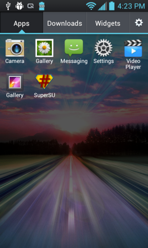

2014-04-25 16.23.37.png<--all apps after reboot, i dirty hacked the update.zip for zvk with no security error boot.img and erased practically ALL apps. it boots! im troubleshooting some technical difficulties atm. its an upgrade so you need zvi.
i will possibly need to re add some of the functions i deleted for gapps to work. maybe some input later? im off to work now.

@ed i was saying yesterday same thing "maybe thats enough to stop it"^ @loki @josh. im not sure if he understood how or or what i meant lol. anyhow, could be thinking of some ways to test. im currently working on the update.zip so not to worry about deleting apps at all. eraseing all unnecessary apps from punch. just booted and gapps works. i readded some google stuff, stock browser, and dl provider. also, you dont have to flash gapps when installing. if anyone wants to try it i will host, its 30-40mb lol.
