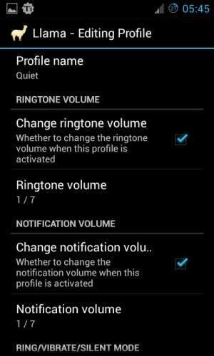

1. First uncheck box for "Link ringer & notifications volumes" in sounds settings.
In Llama, profiles tab, edit the desired profile (night for instance), set the volumes for ringtone volume (3/7) and notification volume (0/7).

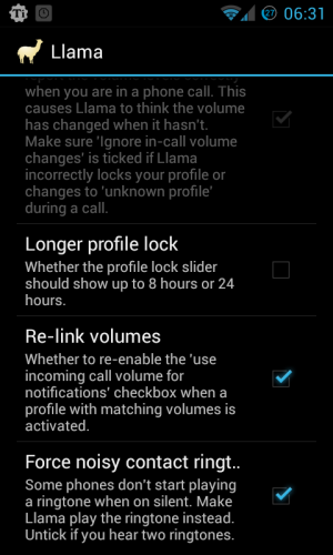

I'm posting screenshots of what I have, in Llama profile settings that's also where you add noisy contacts, just in case. Noting that I didn't have to separate the ringtone and notification volumes to obtain that Llama setting.
EDIT : Also in llama settings there is a relink volumes option. Posting new screenshot
Yeah, it's definitely CM. I tried the re-link volume options, but it doesn't do what I'm looking for. I thought about Noisy Contacts too, but that's just contacts whereas I want any incoming call to ring.
Thanks for checking though.

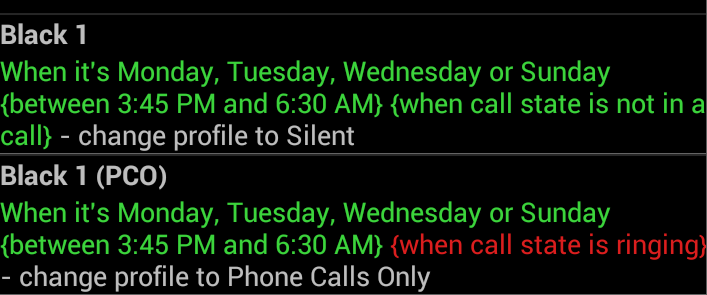

Just tried it. It didn't work :(
Edit: silent profile worked, the ringer profile didn't
