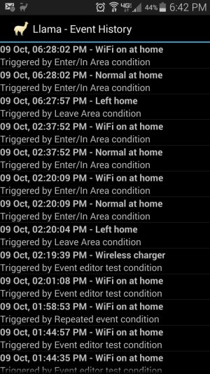

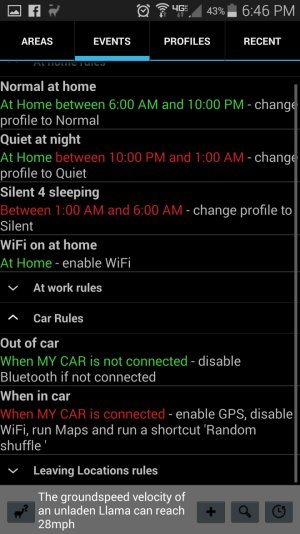

As you can see at the bottom (its been a while), the wifi didn't turn on, even though I was out of the car and in the house. Also, I've been home this entire time, so I'm not sure why Llama keeps thinking I've left. Guessing I'm not getting the same masts throughout my house. But I add all of them -- maybe thats the problem?
Post your events to see what's going on.
So what would the rule look like to launch Google Maps when I get in the car?
If I understand correctly what you want to do, when you get in the car, you should turn on gps, turn your screen on, increment the times it stays on and lunch maps (as an app not as a shortcut). You can start your music app by just executing the play action. Make sure to create the event that returns everything to normal when your leave the car.

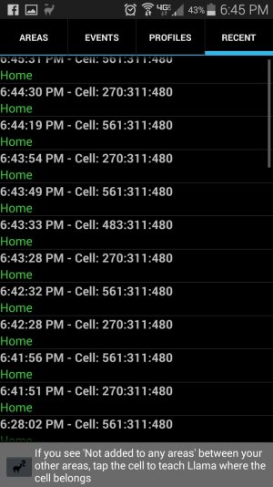

I need to see the details of your events. In the meantime, you should know that cell polling is done every five minutes (by default), so when you get at home, Llama might take five minutes to notice.
Ok, will give the wifi more time and see what happens.
Should I add as many cell masts as possible? What would help Llama realize that I'm still at home? I have not left my house all afternoon (work from home).
