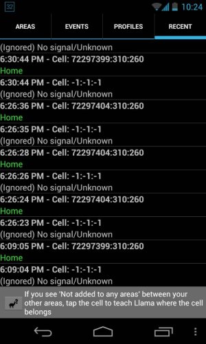

Can someone please explain why I have so many "ignored" events?
Sent from my Nexus 4 on the Solavei network.
Those are ignored cell towers, not events. That's mean you not receive signal from them, I think. The thing is that they are useless for llama.

Should I have llama relearn my home area so I have less ignored cell towers?
Why not? But I think nothing will change. The problem is with the cell towers not llama.
