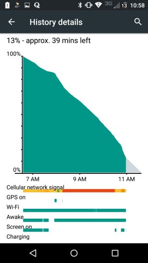

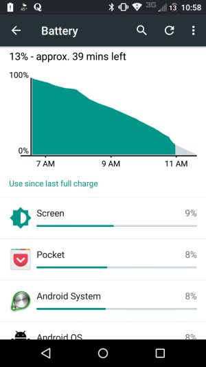

This happened about a month ago then it abruptly fixed itself. Now it's happening again. The battery drains so fast I can barely charge it with a regular charger - have to shut it off or use a quick charger. There were no new apps installed before this started happening.

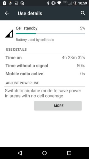

Your cellular network signal data is showing that you didnt have a signal for around two hours (the red area as far as I know means no signal). That would have affected your battery life as your phone would have been constantly searching for a signal during that time

I was at home during that time - my house has pretty bad data signal so I have to use Wifi to get data but it's never so bad that I can't make a call. HOWEVER I've lived in this house with this phone for almost a year and the batter problem only happened a month ago for a couple days and now started again 2 days ago. So not sure why cell network would just now start to manifest as draining battery.

That's bizarre. Something else is also keeping your phone awake for extended periods of time, although I don't know what. Pocket, maybe? Try downloading an app like GSam Battery Monitor and see if it can help you pinpoint what's going on. If you can't locate whatever rogue app or process is burning your battery, it's probably time for a factory reset to see if that clears things up.
