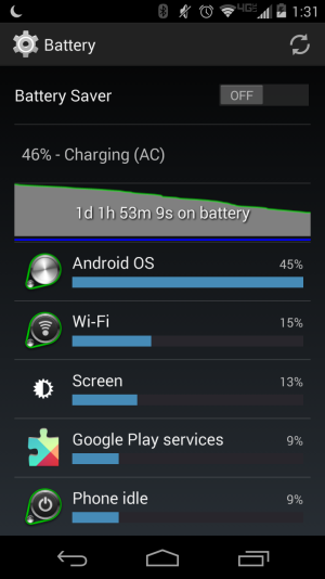

Got my Moto X on Friday. Pretty happy with it. I've been keeping an eye on battery life and so far it's been acceptable.

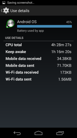

I did have a question though -- in the attached screenshots, you will see Android OS as taking up a sizable % throughout the day. Is that standard? In the Details of that "app", it shows it kept the device awake for over 1.25 hours, and CPU Time of 4.5 hours.
I tried installing a Wakelock Monitor, but those are kaput in KitKat. Despite this, battery life seems to be good, but still wondering if it could be better if there was something else going on here on the device.

I am experiencing the same thing on my Moto X with very high CPU Totals in Android OS when connected to wifi. This is my first KitKat device so not sure if this is something related to that or if its something relating to wifi itself. I have debated doing a factory reset but wanted to check a few other things first as this issue is only when connected to wifi. Just to compare do you use a 5ghz wifi network? I am debating trying 2.4ghz instead to see if that changes anything. I am just running out of ideas. My battery life has been okay but those numbers just never seem right to me under Android OS.

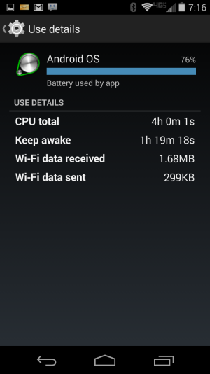

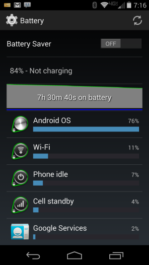

Trust me I do get it. If my Android OS was 99% but I was still getting amazing battery life I wouldn't be complaining but the problem is I am not getting amazing battery life, certainly not compared to the S4 I came from and not based on what others are posting. Here are battery numbers from my idle battery drain overnight. Something isn't right as this is was literally less then 1 minute of screen on time and on wifi the entire time. My S4 running the exact same software, on the same network running 4.3 was at 92% sitting right next to my Moto X. I came on here looking for advise and posted the only information I had at the time and the fact of the matter is that others are having the same issue. Anyway I will continue to figure this out on my own and will most likely factory reset it this weekend.
So info is with your phone totally idle for 7 hrs. 30 min 40 sec. and dropped 16%.?
Before I did a FDR , and since your might still be on 4.2.2 ?
You might want to install Wakelock Detector from the playstore .
Also was anything keeping your phone awake ?

Yes this is with my phone totally idle, just running my usual background processes I ran on my S4. Unfortunately I am on 4.4 so Wakelock detector isn't an option. I am going to try this same test again tonight but this time with wifi off and see what happens as this only seems to happen when wifi is connected. I did have one program keeping my phone awake but I removed it before I did this test. Obviously something is keeping my phone awake when on wifi given that 1 hour and 19 minutes of keep awake. I just wish I could figure out what it is. If I can't figure it out by Saturday I will do a reset and slowly starting putting my apps back on and try to figure this out. Thanks again everyone.

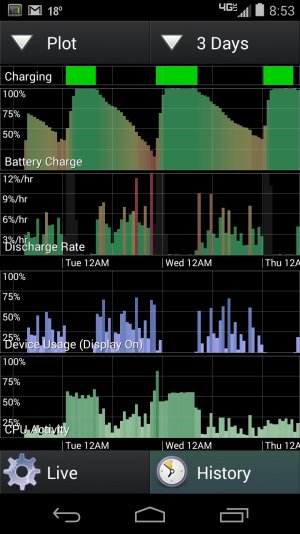

I miss Wakelock Detector and Gsam Batt monitor, too, but SystemPanel by NextApp, Inc was suggested and it works on the X with 4.4. I'll add a screenshot of my 3 Day History.
A comment...16% Batt used divided by 7.5 hours is about 2% per hour...that ain't too bad.

Thanks, I will check that out. Perhaps a 16% drain over 7.5 hours isn't bad but given that something as part of Android OS keeps my phone awake for almost an hour and a half when connected to wifi I imagine it should be better. My S4 only drained 9% although I do realize the S4's battery is almost 20% larger. I am confident I can get to the bottom of it just figured I'd see if others have noticed similar battery drains when connected to wifi.

The 'Plot' view can be switched to 'Top Apps' view to help you analyze...check this that I posted elsewhere...
The only thing that I had noticed being a little strange when reviewing my 2 Day History was that CPU activity was at 50% through the entire Charging cycle for 2 days...Top App then was G+ so I uninstalled update and disabled it last night before charging overnight and today CPU activity looks more normal during the charge.
Can't figure what G+ could have been doing all night for the 2 days?
I've enabled and Updated G+ again this morning and will let it run tonight while charging...maybe the the Update reinstall will have straightened something out.
