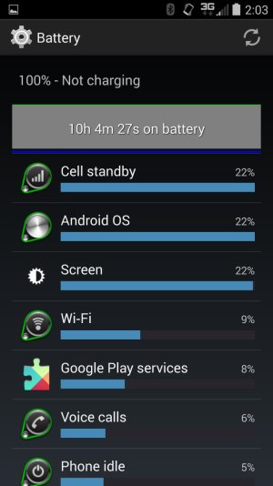

Ok so something is up with the Battery charge level indicators. As folks have noted, it holds at a spot and then just boom drops off. Rebooting the phone doesn't solve the issue. I did have someone experiencing this put it on their turbo charger for about 2 hours and then reboot it and they haven't complained about it. I have a similar issue though, you can see it in the screenshot. This is the 3rd time I have experienced this... but 100% after 10 hours would be kind of amazing..
The problem is at 100% it doesn't want to charge wirelessly (at least thats what it seems to indicate) so I have to plug it in for a while. I'm not sure what "unsticks" it eventually though.
It is a really annoying issue - that is for sure.

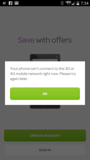

I just got the new Droid Turbo and trying to setup Softcard. I've tried everything. Spent 2 hours at the Verizon store and they call tier 1 and 2 Softcard techs and was told to just keep trying to setup a new account. This is what I have been getting ever since I got my new phones. Anyone else having this issue or know of a resolution?
