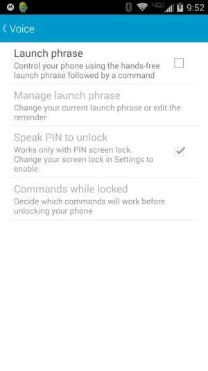

So my Moto (Voice) continuously locks up and crashes. It's now come the the point that it's stuck at the last step where it tells you "Touch the mic to finish setting up voice control". When I click on the final set up it gives me the voice options, the only selection available is "Launch Phrase" with a checkbox but you can't check anything on it. Everything else is grayed out.
I've rebooted the phone, cleared the data and cache and it hasn't worked.

Sorry, I haven't experienced either of these problems; I have the same phone, 3 weeks now, and it's been behaving perfectly since I got it. I suggest you do a factory data reset and then if the problems continue, swap for a new phone.
