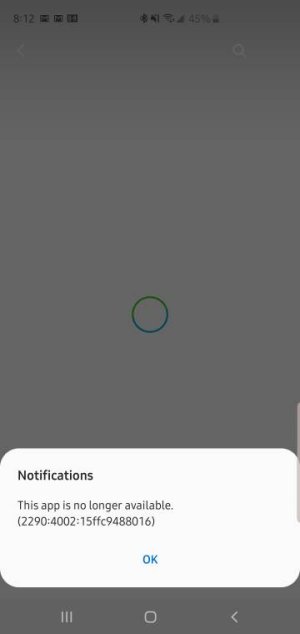

The My BP Lab app was updated to version 2.0. Which supports the ability to take your blood pressure with the watch.
But has anyone gotten it to work? I've tried several times to connect the watch and I keep getting an error message that "This app is not available"

I can't even get that far. I have an older phone and it won't let me even download the app. I plan on getting an s10+, but that is really annoying i can't download the app even though my phone has no problem talking with my watch.
EDIT: I just looked at the app reviews and a lot of people are reporting the same problem you are having. A couple even are claiming samsung might not actually release the blood pressure feature. If that is the case I will be very pissed since that is the main reason I bought this watch

Yelp had the same pop up. I still love my active but disappointed in not being able to use blood pressure. I can do it on my note9 but it is a little uncomfortable lol. Hopefully they fix it soon

So I finally got the Blood Pressure feature to work on the watch. I was scrolling through the apps on the Galaxy Store in the "Watch" section and saw that the "My BP" app was listed. So I installed it. I went to my watch and the app was there. I opened it and it had me install the "My Bp" app from the Play store. Which i had uninstalled about an hour earlier...lol
But anyway, once it installed. The watch calibrated itself to go through the setup process and it worked. The watch is now taking my BP.

I just got this setup on my watch today. I did need to use another blood pressure measuring device as part of the setup. One thing that I discovered was that I was wearing my watch too loose for it to work when I first tried it. I think that I still need to do some calibration to get it fine tuned.
I have tried recalibration several times, but my watch still shows results that are about 20 points higher than my blood pressure cuff. Still trying to get it to work. I am getting a message that it is draining my watch battery.
Well, after running recalibration a few more times I seem to be getting more accurate results. I still get the occasional “draining watch battery “ notifications. It seems like the app gets stuck trying to run? I have been participating in the study. I wonder if the times that I choose to ignore the study notifications are causing it to get stuck and drain the battery?
