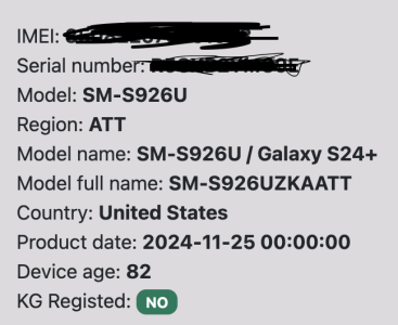

So here is my issue. I live in Pakistan and we get these leftover USA imports. I got myself an S24+ from the lot which is CPID active. If you are not aware of CPID here is the explainer. "A CPID (Client Process ID) phone is a phone that has had its IMEI number changed using server-based software. This technique is used to unlock the phone's IMEI and allow it to work on other networks." CPID phones are normally sold here although illegal they bypass the local taxes that should be illegal to start with. A $1000 brand-new phone will require a $600 unlock tax and an imported S24+ that I got for around $500 still requires $500 tax to be paid. This is another debate.
Now to the problem. This phone seems to have S23 Ultra GCF service provider software version. Screenshots attached. Therefore I am not getting updates on the phone. Last security patch level is November 2024. I am comfortable with using odin and flashing no problems there. I just need direction on:

Can you please tell me what exactly should I flash for my S24+. NOt sure too many options on samfirm
You'll need the latest U1 firmware from sam mobile, samfirm or frija firmware tool and download, you will also need the latest Odin Patch B (Prince Comsey) from XDA website and extract the firmware and Odin on your computer then we can go from there.
That I get. I meant what exact firmware. Attached the exact model.

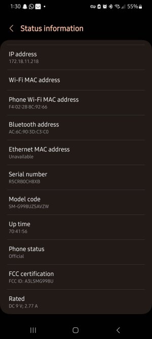

I'm not receiving updates on my S21 ultra but I'm not sure if I'm having the same issue as the other ones you've addressed. If there a way to confirm if the CSC is what is causing that?

What exact model number do you have, and what carrier do you use?

And for carrier, I'm assuming it's internet service provider. I'm from Nigeria and use MTN.

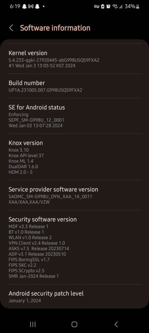

I think so. I am not receiving any updates at all. The last security update was in January 2024,
I really don't understand all these CSC that have been mentioned 101 times in this thread. Is that the method to fix it?

If you go to settings>about phone>software information and scroll down take a screenshot of that page for me
You have a sim unlocked Verizon carrier phone , I would flash to the unlocked no carrier device
SM-G988U is the carrier version
SM-G988U1 is unlocked No carrier version
Flash that version
Flash that version

I left steps and what to download in this thread so review it , you need Odin Prince Comsey(Odin Patch B)
Then download to your PC the firmware SM-G988U1 probably from sam mobile site the latest version
