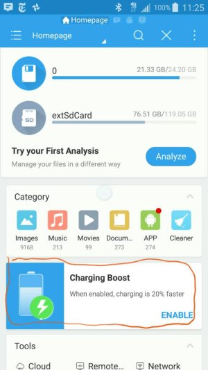

Was ES File Explorer on my device as well, option to turn off is at the bottom of the settings menu on mine.
I do recall a prompt to enable boost charge must have hit yes and not no so in my case its self inflicted

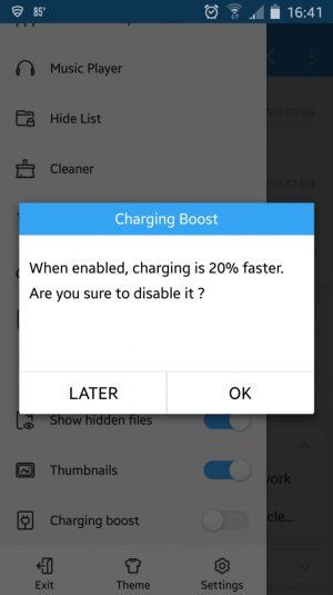

I believe that ES File Explorer is the culprit here. Simply go into the app, open up the menu in the upper left corner, and scroll all the way down to " Charging Boost" then simply toggle the switch off.
