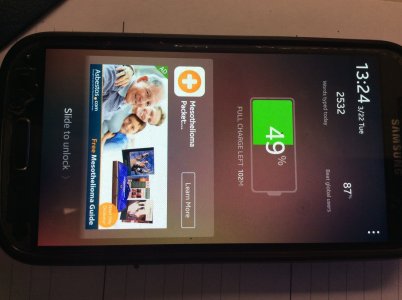

Here's what it looks like...the menu button only pulls up a check box for "boost charge"image.jpg
"Words typed today" indicates that it may be a keyboard app - or it is something that is acting as a keyboard.
So that means the app has had access to everything you have typed into your phone for who knows how long.
If you cannot find the app, and I do not use caps lightly, FACTORY RESET! NOW!
Then change any passwords you may have keyed into your phone.

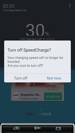

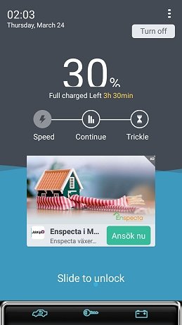

I have the very same problem, after some trouble, I had to reset the phone and used the backup of settings and apps, after it was finished this nag-screen turned up with a included advertise
When I "disable it" then it will not turn up the next time, but after that it's back again
The buttons to click at on the screen is only a decoration
I have been deleting the last installed apps, searching with Google all over the planet, but still no luck
As someone ells here it turns up when I plug my phone into charging - but nothing about what I have been typing.
In some other forums, no one had any answer about this
So I'm hoping that someone here can find a solution, and if I find something useful I will be back

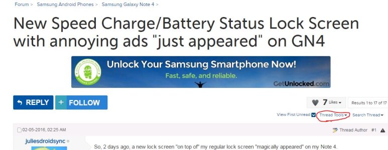

Same exact screen here. How do i follow this thread to be notifoed when a solution happens?
If you are on a web browser, up near the top there is a link called "Thread Tools" and you select "subscribe to this thread". Any time someone posts to it, you are notified.

I don't think that it is Samsung. I started getting the same screen last night and I have been following this string all day. I got about 18 updates last night in Play Store and I didn't start seeing the blue speedcharge screen until after that. Finally went into my applications manager and looked for apps that did not down load and the only ones that I saw came from the virtual reality software that came with the phone (Galaxy S7). It was Cirque du Soleil and Strangers. I uninstalled those along with some camera apps that I had like Bestie and Z Camera and the problem seems to be solved. I just don't know which apps were causing the problem. I did do some research on the Cirque du Soleil and Strangers apps and they seem to be legit. The camera apps that I uninstalled did update right before I started seeing that blue screen though. I hope this helps.
SOLUTION!
Thanks Suzie, You Made My Day!
It was the Z Camera that was messing it up!
When I removed that camera-program everything is working just fine!!
I have been using around 15 programs to solve this, with no luck :)
It might be more programs from the same company "Zero Team" that got this kind of nasty extra function
