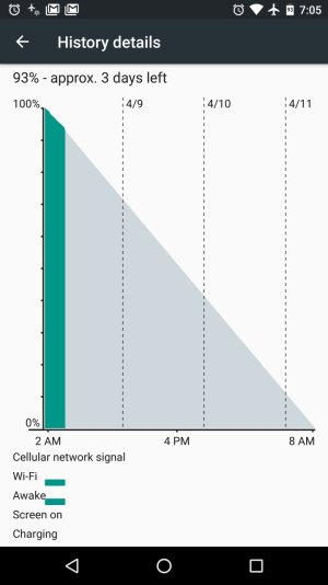

//uploads.tapatalk-cdn.com/20160407/2c00db2e472c698f813a31d5441dae23.jpg
I have been wanting a 6P since it came out. I went from a Nexus 4 to a Note 4 to an iPhone 6s Plus. I hated touch wiz and the fact that I had to wait for over a year to get Lollipop on my Note 4 when Google was just releasing Marshmallow. So due to a super discount from work I got a crazy deal on the 6s plus. The Battery is amazing!! And it's the only thing keeping me from switching. On my Note 4 I would get about 5 hours screen time on average. With the 6s Plus I'm getting between 8 and 10 hours of usage/ screen on time!!! It's sick!! The attached pic was taken just now. I disconnected from charge this morning at about 5:30am and it's almost 11:30pm and I have 9% remaining. And this isn't with the power saver feature turned on either. I really miss the android OS and feature set and really like the 6P but don't want to sacrifice great battery time. Thoughts??
Can you send some more pics with all the apps in usage fromtop to bottom? I don't think usage time is the same as screen on time
