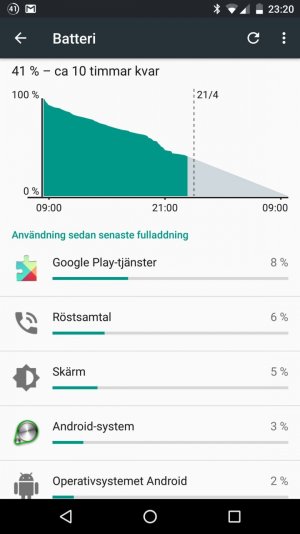

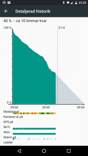

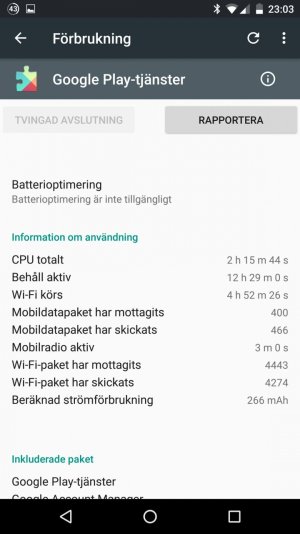

Hi guys!
I have owned my Nexus 6P for about a month now and I love it, apart from one thing, Google Play Services. Like for many others, it has constantly and consistently been eating my battery by keeping the phone active all the time. I have read through some forums and tried turning off location services, running the app "Gservicefix" and so on. These quick fixes only works for couple of hours at most, and then it starts draining battery again by keeping the phone awake.
My phone is running stock android and I have not done anything else to modify it in any way. I also tried uninstalling the Facebook app and started using Metal instead but that didn´t help either.
I´m providing some pictures on how it looks in settings, sorry for it being in Swedish but I hope you get it anyway. 13054805_10207648500582907_467944143_o.jpg13054901_10207648491022668_1473777456_o.jpg13072316_10207648499342876_1312210850_o.jpg

Hi guys!
I´m providing some pictures on how it looks in settings, sorry for it being in Swedish but I hope you get it anyway. View attachment 225211View attachment 225212View attachment 225213
It is unlikely it is actually Google Play Services causing the battery drain. Instead, there is another app that is using libraries provided for the Apps by Google Play Services that is causing the drain. You can try removing apps and see if it makes a difference, though it is typically quicker and easier (because sometimes removing the app doesn't immediate fix the issue) to factory reset the phone. Additionally, on the off chance that something has "broken" in Google Play Services and it is causing the drain, then a factory reset should fix the issue.
Some apps that are known to cause issues with Marshmallow are Facebook, Weatherbug, and Gas Buddy.

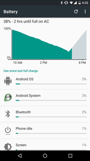

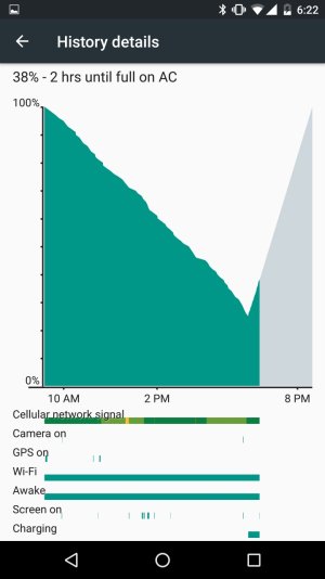

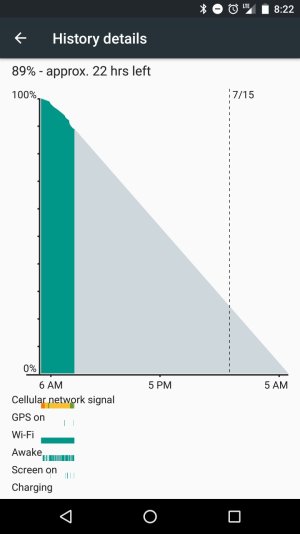

angelbones1, yes, I've noticed a huge improvement since the update last week. For me, it has to do with Bluetooth and huawei watch. For the past few months, when ever I am in range of my watch, the phone is always awake... some kind of Bluetooth wakelock. I'd be lucky to get 12 hours of moderate use on a full charge. But since the update, I'm getting 24+ hours and my phone is actually not always awake!
Before Update
After update - same type of usage. Note it now sleeps!
