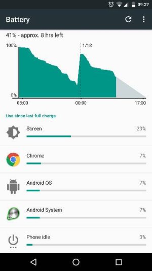

Wouldn't chrome constantly try to fetch data from Facebook and hence end up using more battery anyway? I uninstalled my Facebook app and enabled FB notifications on chrome, however ended up with chrome right below the screen in battery usage. So I turned it off not knowing whether that was the cause...
Posted via the Nexus 6P!
