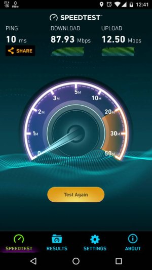

I have a kind of odd, but possibly related question. I've got LTE ... except when I'm connected to wifi, the LTE indicator goes away. Is this normal? It's possible it's been happening all along, but I've only noticed it since the update to 6.0.1; possibly because of a couple of threads about LTE problems here on AC.
It is normal. You're still connected to LTE on the back end but it is just using wifi as the dominant connection for data. As you can see (pic below) I am connected to my home wifi in that screenshot but I have a signal monitoring app (top left) that always shows my mobile connection (which still shows I am connected to LTE on the back-end). :).

Hello, what LTE signal app is that, that your using?

Thank you! That's what I suspected. Most likely I just never noticed or paid attention to the change in the icon until I saw the conversations here about LTE problems.
