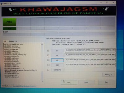

SUCCESS!
The new download worked. I put the phone into download mode and plugged it into the computer first and then added the files Into Odin.
Not sure what region XAA Is but the phone seems faster,
Thank you so much for the help!

This is the steps :
Windows computer needed
Latest Odin can Google it from XDA Forums and download the latest should be Odin 3.14.1 / and Frija tool or samfirm (i usually download both)
Download samfirm v0.4.1 tool and frija, extract it with 7zip.
You will extract files for Odin prince comsey 3.14.1once download with 7zip and will do same for firmware with 7zip .
Put your model number then region and select check for updates , then download the FIRMWARE , extract the FIRMWARE with 7zip.
There will be 4 files after you extract the firmware
BL
AP
CP
CSC
Each of those files will go in Odin when you open to the corresponding slots
BL
AP
CP
Home slot don't out anything
CSC USE HOME CSC FIILE TO SAVE DATA /THIS ONLY GOING BETWEEN CARRIER FIRMWARE OR IF YOUR ON UNLOCKED GOING BETWEEN UNLOCKED FIRMWARE
If you going from carrier to unlock firmware keep regular CSC not home CSC and do a back up it will factory reset the device.
connect your phone with cable to computer , once the files are in its slots hit start, once done you'll see pass in Odin and it will reboot
*Make sure you put phone in download mode
*If dont see your phone connected in Odin change cables or ports in computer .
*Never disconnect the cable in middle of flashing.

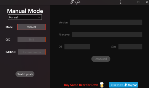

ive downloaded ODIN and Frija. Its currently downloading N986USQSCHYD1/N986UOYNCHYD1/N986USQSCHYD1. Is this the original firmware I already have on my phone? Or should I download the firmware supplied by you on the 1st post?
ive downloaded ODIN and Frija. Its currently downloading version N986USQSCHYD1/N986UOYNCHYD1/N986USQSCHYD1. Is this the original firmware I already have on my phone? Or should I download the firmware supplied by you on the 1st post?
I downloaded SM-N986USQU1DUB5_SPR
That's the carrier firmware so most likely what you have , make sure it's Odin Patch B, in Frija choose manually not auto and put model number N986U1 not N986U
thanks for that...do I leave the other boxes empty? and I downloaded Odin3_v3.14.4 or is there a different location to download the PatchB?
I just got the Odin3_v3.13.1_3B_Patched_Samfw.com version?

Use this Odin
XDA Forums
Patched Odin - XDA Forums
As for the CSC use XAA and put your IMEI number
