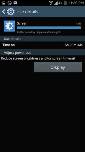

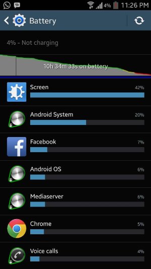

Hi all. I see people reporting 6 hours of screen on time for their note 3 with heavy usage. But i find myself in a much different position with my sm n900. If i dont enable the power saving mode, i feel lucky to reach 4 hrs 30 mins of screen time. Screenshots were taken with power saving mode enabled. Brightness is half (auto). I use wifi at home, and 3g when I'm out. The wifi and 3g usage per day is almost equal. The phone is unrooted and stock running kitkat with touchwiz, no useless apps. I have a few games, email and mostly social networking apps (facebook, twitter, ig, bbm, whatsapp, snapchat, tinder, bitstrips).
What am i doing wrong? And please, i don't wanna reset my phone. Is there any other solution? Thanking you all in advance.

Nothing the other people use low brightness power saving mode and are probably either lying or insane if they say they get more than six hours also what font is that and another note most users with good battery life are on 4.3 like me

The system is very inaccurate as far as screen-on time reporting goes. 6 hours of screen-on time isn't really attainable for the most part, unless you run at 5% screen brightness.
If you really want to be sure how accurate the reporting is, test the screen-on time manually, and compare against the system. GSAM has the same inaccuracies, probably because it reports from the Android system, same as the native battery app. I did some testing and found it to be way off...

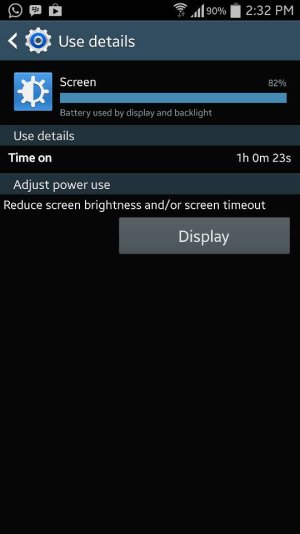

I definitely see some improvement after disabling the features that you mentioned. Getting to 1 hr screen time within the first 10% was a big deal for me prior to posting this thread.

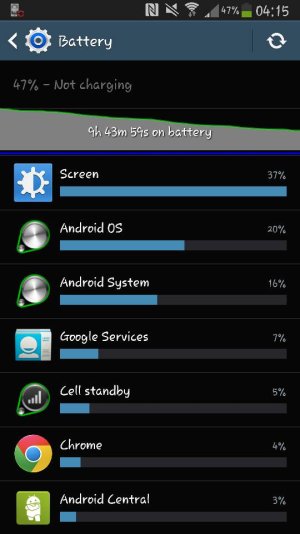

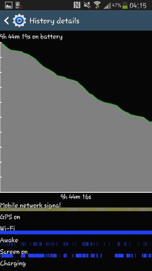

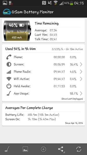

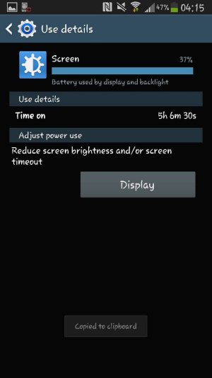

Firstly, I don't think it's right that you accuse the people here of lying. There may be a small portion of people here who will lie about their battery life etc but the large majority of people on here are honest and helpful. You yourself should know this from the postings you have created in the few weeks that you have been a member.
Secondly, it is possible to have good battery life and screen on time. I'm posting a screen shot of my battery life from gsam which has monitored my battery life for the last 6 wks or so. It shows my average battery life is 20 hrs 9 mins with 7 hrs 10 mins of screen on time.
Also including screenshots of my battery life right now. I'm close to what the original poster has in terms of battery and screen on times yet I still have over 40% of my battery life left.
Original poster - if I were you I would also monitor what is running in the background which may be keeping your phone awake (such as the social media apps you have running) and draining the battery.
As for my screen brightness etc - my brightness is set to about 20-25% when inside and when I am outside (san diego - lots of sun) I put it up to about 55-65%.
I don't use the power saver mode - tried it and didn't like it, plus I get good battery life so I really didn't need it.
I don't use facebook, etc but I do have Whatsapp and I have 8 email accounts all set to push. I have gps/location, wifi, data on all the time, as well as nfc, air view, sync, and sbeam.
I find the screen on time on gsam vs settings>>battery>>screen to be pretty much the same ...usually just a few minutes of difference.
I'm sure others will give you more advice on things to try so you can improve your battery/screen time.
Sarks.

@ Sarkycow -
Please help me understand, and since you have all the data in Excel, plus manual testing, you should have the answer!
Your screenshot indicates the phone having been on for 9 hours 43 minutes and 59 seconds since last full charge.
You are at 53% used on this battery
You show 37% screen usage, which equates to about 3.59 hours of screen-on, yet you show 5 hours 6 minutes and 30 seconds of screen-on.
Can you explain that so I understand?
You have tested manually, where you leave the screen on idling for the whole time until the battery dies? How long did the charge last?
When I turn the screen on, and do nothing - in other words, I don't touch the phone at all...actual screen on time works out to less than half of what is reported by Android or GSAM.

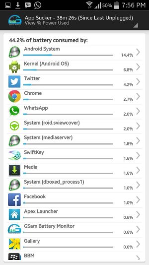

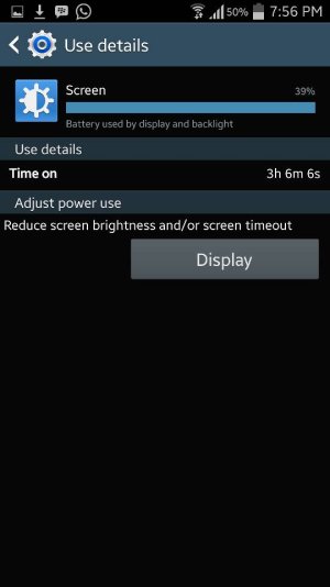

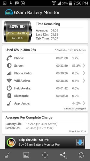

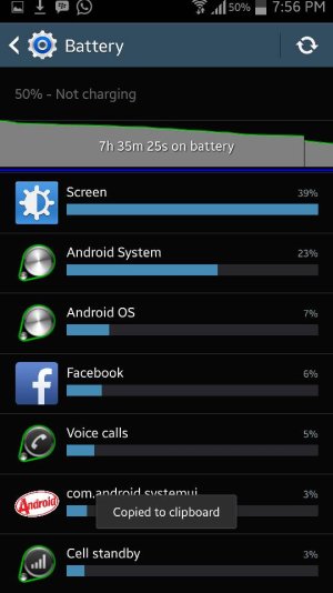

I did as zero bim said, and the results have been good so far. But then, i didn't leave home today so i was connected to wifi the whole time. I've noticed that 3g kills the battery.
I had to restart the phone, that might have effected the stats in gsam.
This is with power saving mode enabled and apex launcher.
