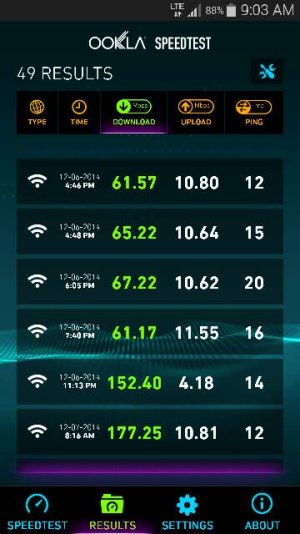

I get great speeds.
5Ghz network.
Posted via Galaxy Note 4
