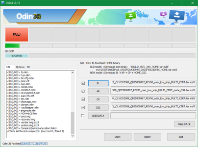

I've used Odin 3.13.1 3B Patched, 3.13.1, and 3.14.1. All of them fail.

Can you take screenshot of what slots you using in Odin?
3.13 is good for this install

The first time that I tied this, I used all the slots in Odin except for USERDATA, because a youtube video I saw showed the guy not using that one. After that, I've always filled all the slots. Again, the first few times I tried, I used the HOME_CSC, and other times I just used the CSC. (So, I'm not even sure if my data is still on there...I'd LOVE for it to be there, just for the sake of not having to set everything back up.)
I'll try to send a screenshot when I try this next time, if you need it.
Yes user data no need CSC will wipe the phone and the home CSC keeps the data

Nope. The file posted at the first link in post 74 of this very forum. Trying again with the USERDATA box filled. (What is that one, anyway?) I know that the others are bootloader, network, etc., but I don't know what that one is.
Failed again at the exact same step. I think it's always the same: system.img.ext4.

The file is corrupt , get it from another source
