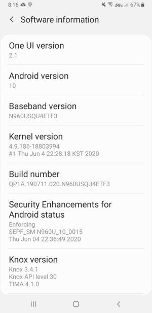

Note9 rolled out today OneUI 2.1, i already have it on my AT&T Note9 since yesterday. So check your software updates

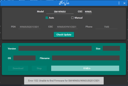

Thank you very much for the swift response, I went ahead with frida and I'm getting this msg, I'm pretty sure I'm doing something wrong =( frija.png
Nvm, i just saw your edit, found it already, so it is safe to just move from n960usqs1csd1 to the one Frija provides?
