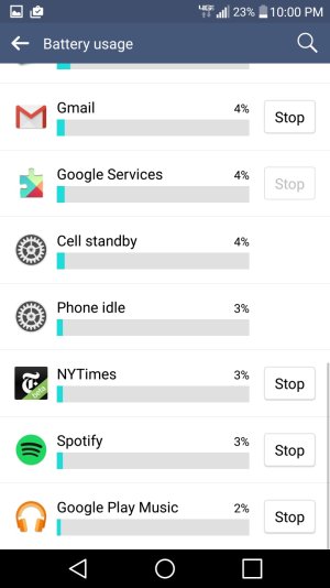

Today I used the phone mostly for reading web pages and NY Times app, under an hour of streaming music (with screen off or while reading and headphones), a half dozen photos, a few short phone calls (not VoLTE). Total screen time used so far: 2 hours 3 minutes. Screen brightness: Auto 43%. Mostly LTE, a little WiFi use. Battery left: 23%. See screenshots. Thanks for any input you may have.

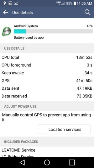

I did notice that today my phone is using GPS way more than it should, but I don't know what's triggering it.Screenshot_2015-08-12-11-05-05.jpg

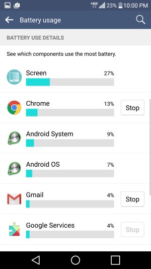

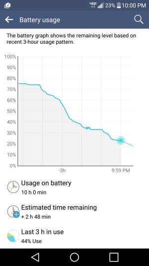

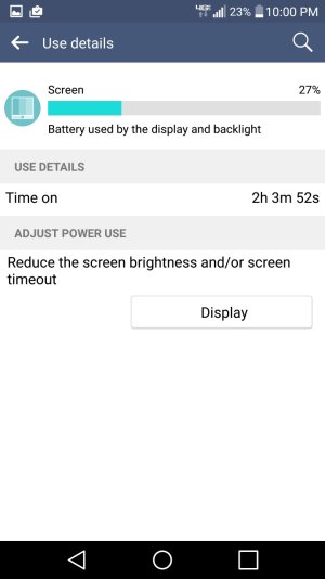

Something seems to have triggered it for sure. I just happened to the screenshots of my battery life yesterday and Android System didn't use GPS at all after about 15 hours up time.
Probably going to have a pretty negative effect on your battery life today.
So I did a factory data reset, for the 2nd or 3rd time, and I'm seeing improvement finally: android system, play services, and other OS resources are consuming less battery, leaving more for screen and other apps. The issue appears to have been the near constant GPS use by Android system with no indication of which App or process was requesting it. However, I'm now working on a bare phone with almost no apps or changes and I'm paranoid that something I do will re_trigger the problem but I won't be able to pinpoint the cause. I think it's too soon to declare victory, but perhaps I can be cautiously optimistic. If I reach or exceed 3 hours SOT tomorrow I'll be pretty happy.

I have 50% battery left with 2h 26 minutes of SoT, and usage on battery is 16h 34 minutes. This may sound normal to you, but the brightness I used in this time period is 0%! Yes, with zero brightness, I won't even reach 5 hours of SoT.

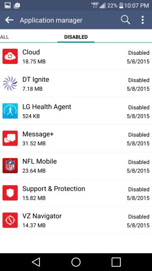

I don't have any games installed, every possible bloatwares are disabled/uninstalled, no auto-sync, no nfc-data-bluetooth,location! I only had wifi on, usually. Only when needed. Do you think this might be a bad battery?
Every answer is welcomed.
It isn't a bad battery. There is most likely some work needed to track down battery wasters. If you have been following the thread I'll use myself as an example for tracking them down. First things first looking into wakelocks will point out the biggest of them. Many of those have been pointed out in the thread. Depending on how much each waster is wasting you could gain anywhere from 1 to 3 or more hours of time on a full charge with keeping the same screen on time. Resulting in more battery available for more screen on time.
I used access lock and turned off permissions to location in every app that wanted it except for one app that I use that needs it in order for the app to do what I use it for. Also I recommend changing location services to mode GPS only. Using either of the other two options consumed significantly more battery. Which is odd when you consider power savings option is supposed to use the least. The problem was that it and high accuracy were causing hundreds of more wakelock compared to GPS only. Also I found google location history and my place turned on both were significant drainers as well that weren't really benefiting me so I turned them off. They would be using GPS et al hardware used by the mode set.

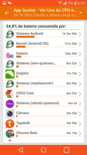

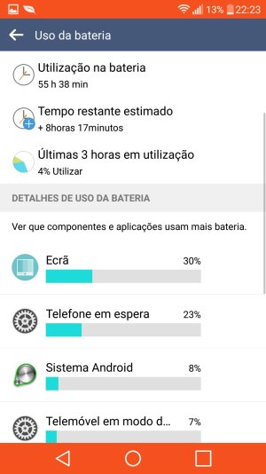

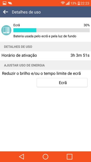

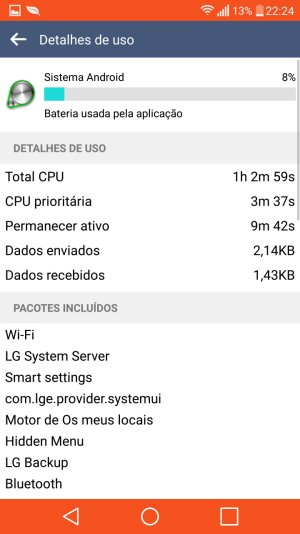

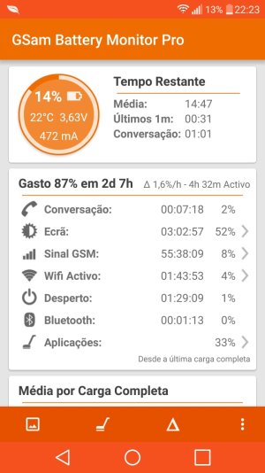

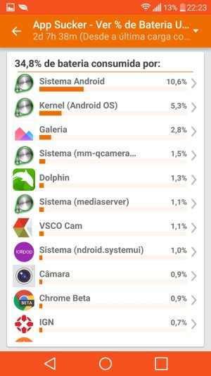

Hello all again. This is my 3º charge.
What you guys think? Since i dont know nothing about this stats :p
Ps: 3h sot atm at 10-15% batt left.
