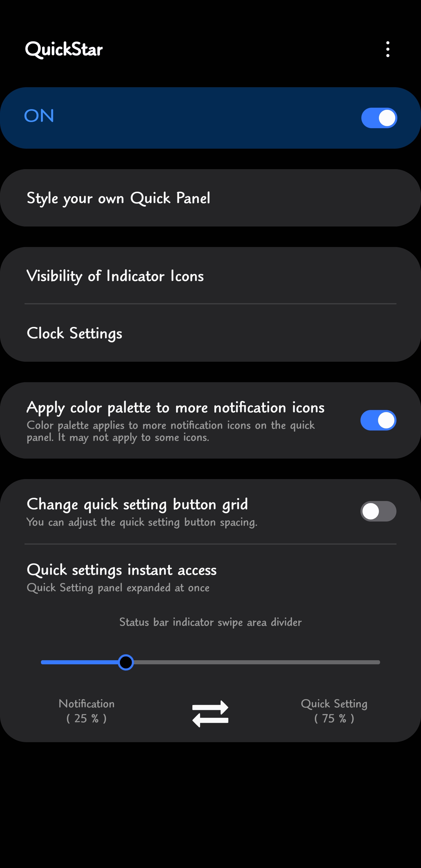

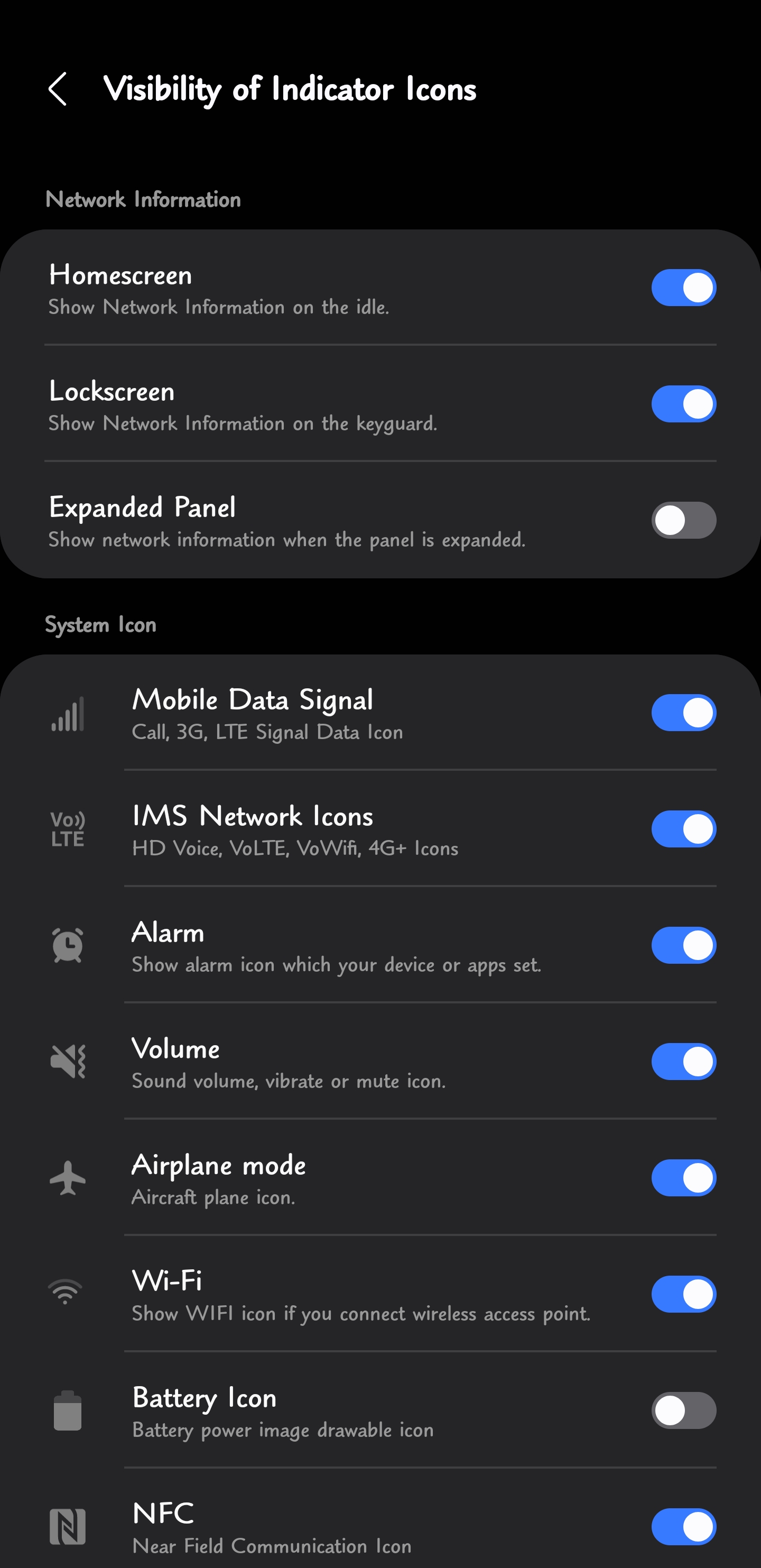

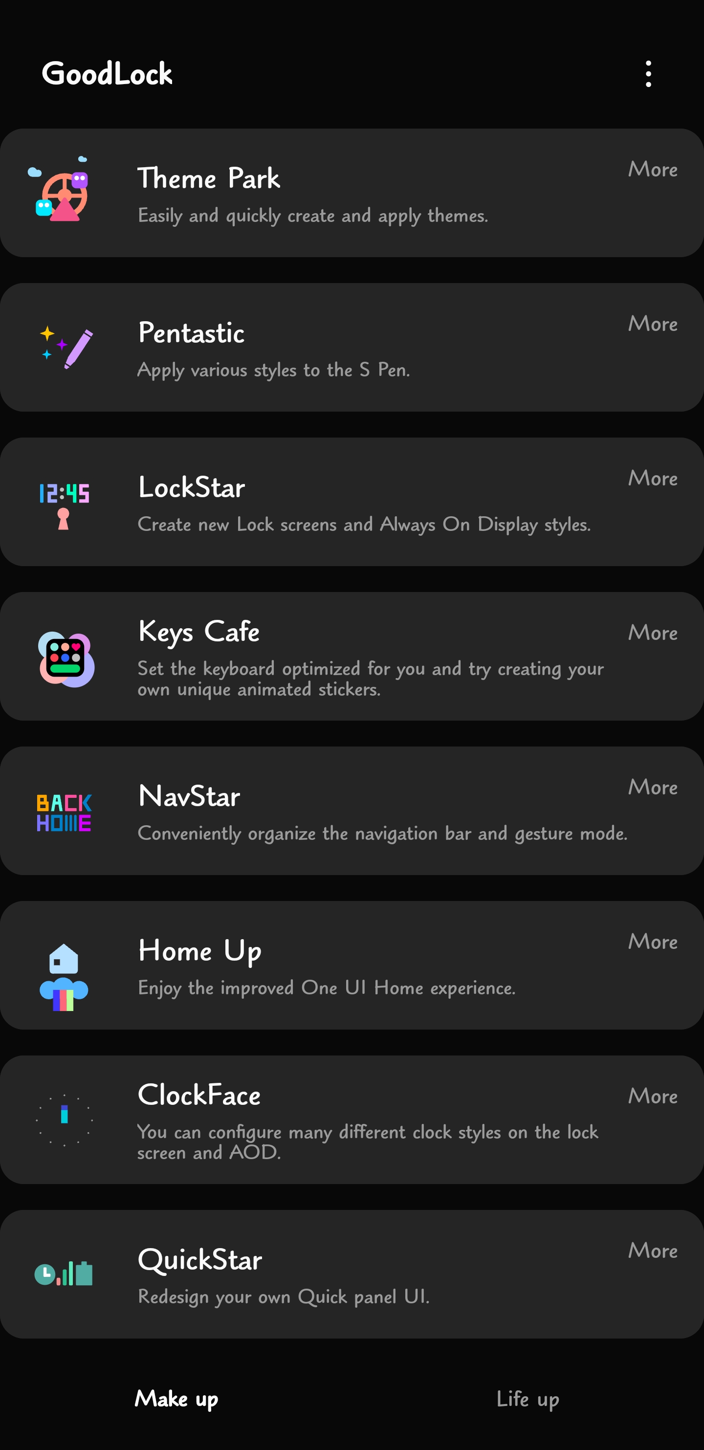

Do you have Good Lock? If not then you can get it in Galaxy Store.
Open Good Lock, tap on Quick Star, tap on visibility of indicator icons, then select the ones you want to see.
Thanks, great tip - I hadn't heard of this app before. I've installed it but sadly it's still missing the 4G or 5G (or wifi calling) indicators.

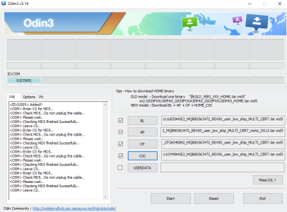

I'm assuming something with the flash process didn't go well , did you do a one file flash to Odin or you used all 4 files from the firmware to the corresponding slot in Odin?

I did the latter, all 4 at once - can that make a difference? I can redo it if possible (might need a quick guide on how to do it this way).
You put each firmware that corresponding with Odin , so not the firmware in just AP?
If you followed sammoble site to load all firmware into one slot AP that's wrong just so you know.
Oh crap that sounds like exactly what I did - will post the screenshot when I can though so we can make sure I'm doing it properly. If I've missed a step then hopefully it's easy to resolve.
Yeah sounds like it , ok no problem when you're ready.
Right, here's how I've been doing it. I load up all these files here and then press Start and wait for it to finish and my phone to restart as well:
Is this correct or am I doing something wrong?
