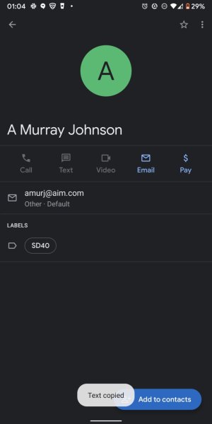

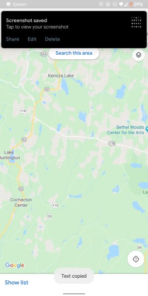

Hi, I'm the OP happy to see some action in this thread. Fyi I am using a pixel 2 xl with default launcher, not rooted, no app cleaner, running lookout for security. I'm considering reinstalling firmwear as soon as I convince myself that the risk of making it all worse is low.
I get persistent toasts from standard apps like Contacts and Settings as well as private apps like MLO, my task manager. They persist after the app is closed. Here are some screenshots:
The first shot shows a persistent "text copied" toast. Fyi notice that it is slightly transparent, showing a bit of the blue "add contact" button.
In the second screenshot I have closed the contacts app and the toast is showing against the home screen. Also showing at top of page is a second toast about the first screenshot I took
Now I'm in Maps, the text copied toast still present and the first screenshot toast replaced by the second screenshot toast.
As you can see the phone is not locked up, however if I need to tap a button or a keyboard key that's hidden by the toast I cannot proceed until the toast clears, although sometimes I can see the button through the transparency of the button or by rotating the device
