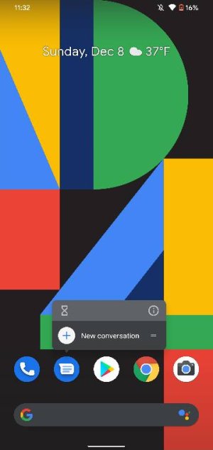

Hi, sorry we having a hard time understanding what is being said but on your home page if you long press message app a little box opens up then to right of it. Is a circle if tap that that's info button it will bring up force closeScreenshot_20191208-233214.jpeg

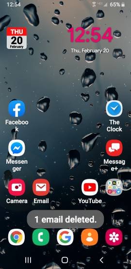

Im experiencing this with my emails once deleted, the message "1 email deleted" sticks around quite a while. Really irritating!

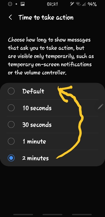

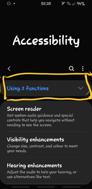

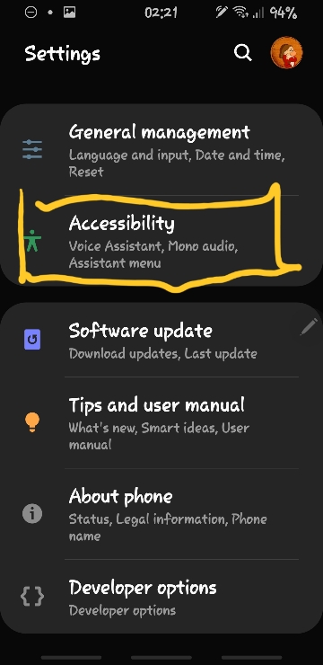

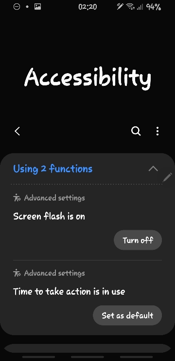

OK I think I have found a solution.
If you go, settings, Accessibility then open "using 2 function" then under "Time to take action" set this to default. I this cured it for me
