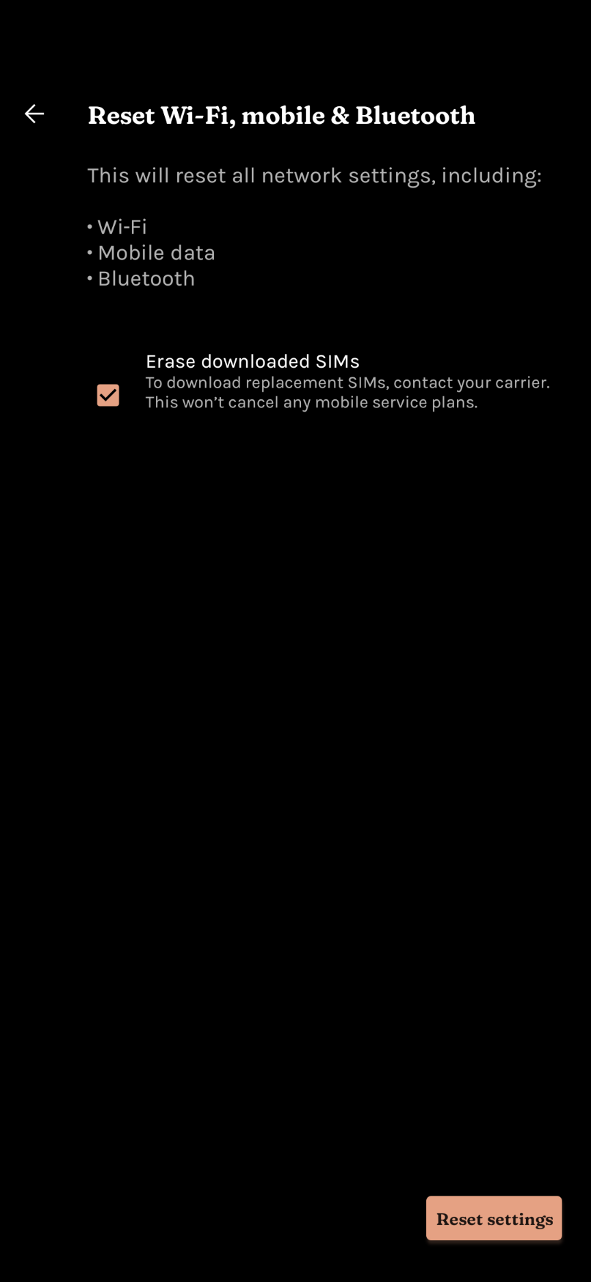

I'll look at my pixel running Android 10 tomorrow and see where the reset feature for bluetooth is ;) If you're running 11 it might be different.... but you want to find the options to reset your network settings, the option to reset bluetooth settings should be there as well.
It's under settings/ system/ reset options
