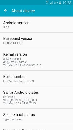

I had exactly this problem and tried all the solutions mentioned in this thread except rooting my phone. I even took off the back of the phone and reconnected all the micro-connectors inside. Nothing worked but I noticed when I took out the battery for half and hour, the wireless came back on for about 30 secs before failing again so I left the battery out overnight and when I put it back in, hey presto, it worked. Spent too many hours trying to fix this so if you've read this far into the thread, I know what you're going through! Anyway, try this, and get a good night's sleep. Hope it works for you.
Update! After the Wifi was working for about 4 hours, it has now stopped working again, reverting to exactly the same problem described in the very first post of this thread. It clearly isn't a hardware issue as if it was, it wouldn't work at all but something is conflicting somewhere. I'm at a loss, any further idea's anyone? These are my phone's details
