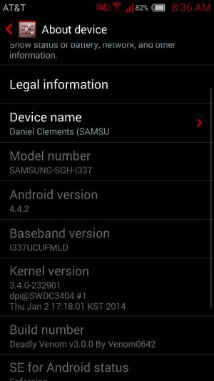

I need this screen settings#more# about device
I need the base band it's your modem/ boot loader
If your in the states and on at&t I recomend deadly venom it's based off of the i9505
