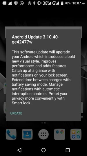

My Note 4 pops up the message, Android Update 3.10.40-ge42477w and wants me to update. Is it safe to update? When the popup is displayed, it disables all functionalities on the phone and the only way i can temporarily get rid of it is to reboot my phone. This popup comes up at 3-5mins intervals.
Please advise if i can proceed with the update. If not, how can i permanently get rid of the popup?

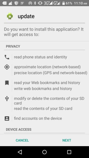

I get exactly same message on my Micromax E484 phone w/ Lollipop. This was independent of the genuine micromax OS update request - which I did recently. Temporarily, I get out of the screen by clicking UPDATE and CANCEL in next screen. Keeps popping up every now and then. Kinda bothersome! But, would like to know if this is safe to install and who is the publisher? I noticed some spelling errors which forces me to think if this is genuine at all. But, even with CM Security installed, do not know how to get rid of this if not required. Please suggest. Screenshot attached.Android Update Pop-up.jpeg
One more image...
Pls suggest if this is safe to install or how to get rid of. Doesn't seem to be from Google. I have a kernel version: 3.10.72; build number: MMX_E484_SW_V19_HW_V1.0.0_23082016; Custom Build Version: ALPS.L1.MP2.V1.29_LCSH6795.LW.HZ.L1_P111. If this info helps. Android version is - Lollipop (5.1).
Thank you for the screenshots. Like you, I judge the message to be fraudulent. Try Safe Mode to test whether a third-party app is the cause.
