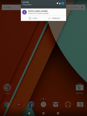

It's been a few days since I last used my Nexus 9. I picked it up today and noticed I had an update 5.0.2 ready to download. Is this old news? Last thing I knew was that the Nexus 9 was stuck on 5.0.1 until they would update to 5.1.1.
That's strange... Nexus 9's never received 5.0.2 only the N7's & N10 received this update.
Did you try it?
Yep. I installed it and everything. It seems to work just fine.

WOW!!!
Congratulations, you're the First person to receive an update beyond 5.0.1 for the Nexus 9 ;)
I would venture a guess that it might have to do with the coming 5.1.1 update (maybe something in 5.0.2 is needed before the jump??).
That's just speculation though...
Interesting none the less ;)

Have received the 5.0.2 update this afternoon too. Put it down to maybe a pre-requisite for 5.1.
