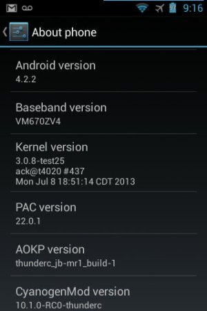

if you want bluetooth functionality at the cost of accelerometer, compass, and battery charger notification, you can try out my alpha build now.
Just be aware that it is still alpha until all the hardware works.
I've been using it on my daily driver for long enough that I consider it stable, just imperfect.
You'll probably want to swap home/menu keys for the Optimus S. My keyswap zip needs tested.

Experimental builds for use with bigsupersquid's alpha kernel. JBC build 3 for the 3.0.x kernels. CM-10.1. The included kernel is older and unstable build, so you will need to flash the updated kernel above after flashing the rom.
Build 4 JBC with updated kernel, wifi sleep and wakeup fixes, wifi hotspot might be working, taking photos might be broken, just needs a revert , Goo.im Downloads - Browsing For
-- already has sprint keypad and updated kernel. So just flash the rom and gapps.
Build 3 JBC as 6-26-2013 includes an old 3.0 kernel, with HALO Goo.im Downloads - Browsing For ... flash rom, kernel, gapps.
Build 2 JBC without Halo cm10.1-20130614-thekraven-LS670-experimental2-novatek.zip ... flash rom, kernel, gapps.
As noted above, accelerometer, compass, and battery charger are not working yet. The above roms only work with the 3.0 kernels.
To install, flash ROM, flash kernel, flash Gapps. You may need to flash his OS sprint keypad zip to swap the home and menu buttons. STill ZVD based.
