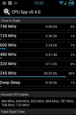

You're lucky my phone gets no deep sleep on this rom
Sent from my LG-VM670 using Android Central Forums

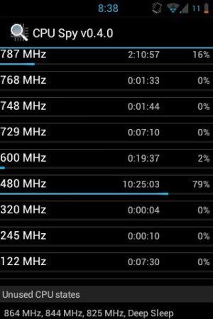

This is on the 32 kernel.
Sent from my LG-LS670 using Android Central Forums
