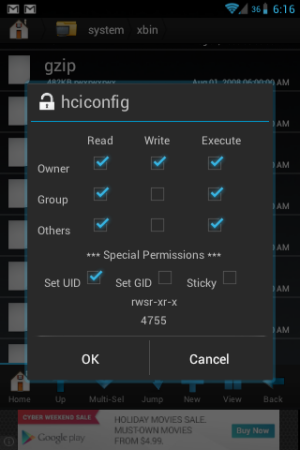

Yes that works for any phone. All it does is change permission on 3 files if you use bluetooth. You can change permissions manually via Rootbrowser on 3 files in the system/xbin directory. hciattach, hcitool, and hcidump. And just add a check to Set UID on all 3, which changes permission to chmod 4755
