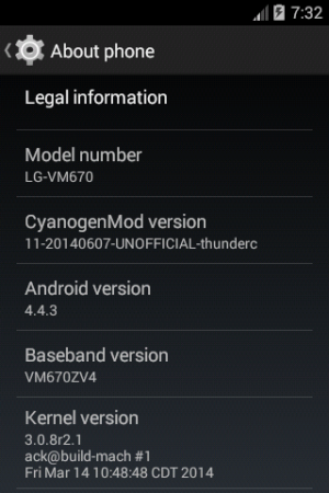

just for fun, pulled 4.4.3 and going to try to build.
Low expectations... but who knows without giving it a try.
Kernel source has update too.
still bootlooping. Looking into what is actually running. it gets to dexopt of some system stuff then hangs. Probably killing processes like last time.
4.4.3!!
OMFG, it's just done something natty to the boot.img, I bet I messed something up in the device folders.
Swapping in an older working boot.img brings up full boot with new internal build.
I'll get it working enough to upload something new before too long :)
